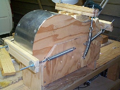

Here's a really neat set up that Mike Doolin uses that has the steel attatched to the bender. One day soon I'm going to get around to making one.
Doolin bender
Mike has some really useful stuff on his site.
